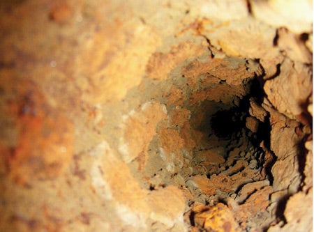

Case study #1: Pay me now or pay me later. It was a jump in the cost of molybdenum that contributed to problems in the mild steel piping in a chilled water system. As the cost of the metal increased and treatment costs kept pace, the decision was made to cut expenses by using much less treatment than is typical in these systems. The result was massive corrosion (Figure 1) that required replacement of major sections of the chilled water piping.
1. Out of balance. Failure to maintain proper levels of treatment resulted in a short-term gain and long-term loss for this piping system. Courtesy: M&M Engineering Associates Inc.
Once corrosion cells are established, they are very difficult to stop even if treatment is reestablished at the proper level later on. Corrosion cells also set up excellent homes for metal-munching bacteria. It also takes time for the symptoms to become obvious, so things may appear to be going great for a while, but sooner or later, the corrosion comes home to roost.

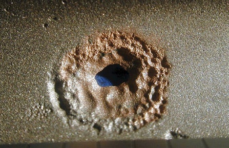

Figure 2 shows copper nickel tubing from a heat exchanger that failed due to bacteria deposits. When the tube deposits (which included calcium carbonate and silt) were removed from the sample, there was an area of pure copper metal around the failure. Preferential attack of one component of an alloy is a characteristic of microbiological-influenced corrosion. DNA analysis of the deposit proved that there were significant populations of corrosion-causing bacteria in the deposit.
2. Surface blemish. This heat exchanger tube failed because the bacteria did their work well. Courtesy: M&M Engineering Associates Inc.
