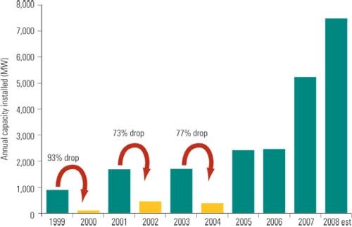

"Historically, when the PTC has been allowed to expire [Figure 2] before being extended (in 1999, 2001, and 2003), wind energy installations dropped by as much as 93% in the following year," he said. "Over the longer term, an array of stable and supportive policies are needed." (See the Commentary, p. 156, for international evidence of this dynamic.)
2. Gone with the wind. The number of wind turbines installed dropped quickly each time the U.S. production tax credit expired. Courtesy: American Wind Energy Association
