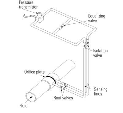

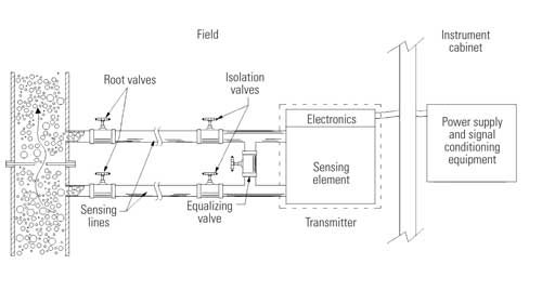

Figures 1 and 2 illustrate two different views of sensing lines. As these figures show, sensing lines connect a pressure transmitter to the process. Depending on the application, there may be one or two sensing lines for each transmitter. Both liquid-filled and gas-filled sensing lines are used in industrial processes. Liquid-sensing lines typically contain the process liquid or oil, depending on the sensing line’s design and application. Gas-sensing lines typically contain steam, air, nitrogen, or other gases, and there is sometimes a transition in sensing lines to another medium, such as oil or water. A diaphragm, bellows, or condensate pot is used in the sensing line for the transition from one medium to another.
1. Get it right the first time. Example of a proper pressure transmitter installation. Source: Analysis and Measurement Services Corp.
2. Isolation valves required. The typical pressure-sensing system design uses a combination of isolation valves. Source: Analysis and Measurement Services Corp.
