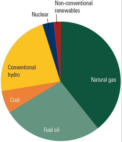

Mexico relies on combined-cycle plants, primarily running on gas, to supply its base load. As Figure 1 shows, natural gas is the most prominent energy source. The Comisión Federal de Electricidad (CFE) has invested considerable capital in converting its existing combined-cycle plants from running on fuel oil to running on natural gas.
1.    Energy sources for Mexico’s electricity generation. Source: LVHS
This conversion to natural gas has encouraged investments in liquefied natural gas (LNG), resulting in the CFE becoming the largest shipper and consumer of LNG in Mexico.

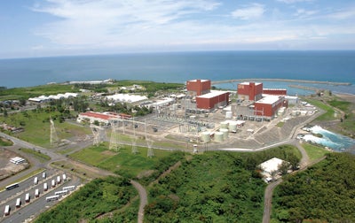

Mexico is home to a 1,365-MW nuclear plant, Laguna Verde, which is currently being upgraded to increase its capacity by 20% (Figure 2). Enrique González, president and general director of Schneider Electric Mexico, is an advocate of this source: "Every year the technology gets better. It has significant benefits over fossils fuels. I believe the country needs nuclear energy."
2.    Laguna Verde. Located in Alto Lucero, Veracruz, this 1,365-MW nuclear generating plant is being upgraded to increase its capacity by 20%. Courtesy: CFE
However, critics of nuclear expansion argue that there are still lingering doubts over safety and that the long lag time and the high upfront costs make it more difficult to justify on a financial basis. Andrés Flores Vargas, commercial director of General Cable Mexico, which supplied certain cable components to the CFE for the Laguna Verde plant, predicts further investment in nuclear generation in Mexico: "We supplied products for Laguna Verde, and one of the reasons we have massively expanded operations in Mexico is that we believe that there are growth opportunities here and not just in the nuclear area."
