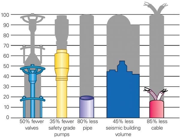

5.    Inherently safe design. The inherent passive safety of the AP1000 derives from its modular construction design, which has fewer pumps and valves than the typical plant operating in the U.S. today. This increases reliability and reduces maintenance and operating costs. Source: Westinghouse

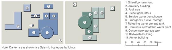

The AP1000 plant is arranged with five principal structures — nuclear island, turbine building, annex building, diesel generator building, and radwaste building — each on its own base mat (Figure 6).
6.    Reduced construction required. The AP1000 plant arrangement consists of five principal building structures: the nuclear island, the turbine building, the annex building, the diesel generator building, and the radwaste building. Source: Westinghouse
The nuclear island consists of a free-standing steel containment building, a concrete shield building, and an auxiliary building. These are the only Seismic Category I structures required with the AP1000 design. The foundation for the nuclear island is an integral base mat that supports these buildings.
The safety-related equipment designed to perform accident mitigation functions is located on the nuclear island. Therefore, the nuclear island structures are designed to withstand the effects of natural phenomena such as hurricanes, floods, tornados, tsunamis, and earthquakes, as well as the effects of postulated internal events such as fires and flooding, without loss of capability to perform safety functions.
To preclude adverse interactions, the plant arrangement provides for separation between safety-related and non-safety-related systems and equipment. This separation is provided by partitioning an area with concrete walls and provides confidence that the safety design functions can be performed. The remaining nonseismic structures do not contain any safety-related equipment.
