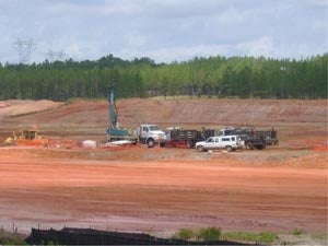

Displacement in below-grade soil and rock is being monitored using an integrated system of highly accurate Geokon extensometers, displacement transducers, and pore pressure transducers. Other applications of this instrumentation include the measurement of ground movements around tunnels and behind retaining walls. Data obtained from the instrumentation at each monitoring location are collected several times each day and transmitted on-site by wireless radio from data loggers at each monitoring point, and then transmitted off-site via an IP phone to a central bank of data servers. Courtesy: J.M. Hylko

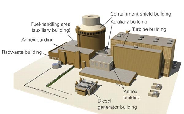

On August 26, 2009, the NRC issued an ESP for the two new units at the Vogtle site. Southern Nuclear’s ESP is the fourth such permit approved by the NRC but the first based on a specific technology: the Westinghouse AP1000 PWR (Figure 4).
4.    New PWR ready for business. The AP1000, based on the proven performance of Westinghouse-designed PWRs, is an advanced 1,154-MWe nuclear power plant that uses the forces of nature and simplicity of design to enhance plant safety and operations and reduce construction costs. Source: Westinghouse

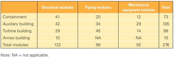

Table 2. Typical breakdown of AP1000 modules.
