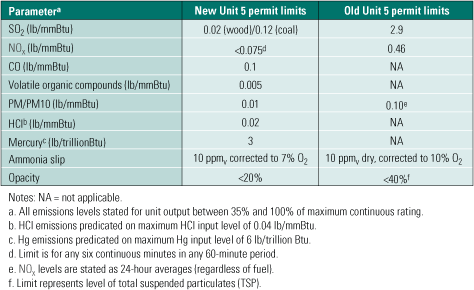

Air pollution controls on the Alstom CFB include a selective noncatalytic reduction (SNCR) system that uses urea supplied by Fuel Tech Inc. (www.fueltechnv.com) for NOx control, a limestone injection system to control SO2 and acid gases when burning coal, and a baghouse fabric filter from Wheelabrator Air Pollution Control Inc. (www.wapc.com) for limiting particulate emissions. The repowering of the Unit 5 boiler has produced net decreases in emissions of the criteria pollutants PM, PM10, NOx, and SO2. However, the project will result in increased net emissions of CO and volatile organic compounds. The table summarizes the net emissions increases/decreases permitted for the repowered Unit 5.
The Northern Wood Power Project's emission limits reflect lower wood emission rates. Source: PSNH
