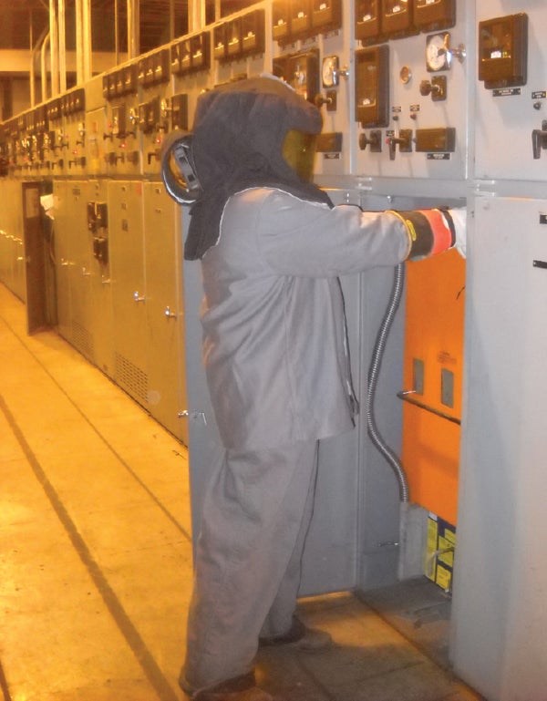

  • Development and implementation of the National Fire Protection Association’s 70E standard for electrical safety in the workplace (Figure 7).

7. Protection against electrical hazards. The MP&W staff identified all of their electrical equipment hazards and developed the facility’s 70E Electrical Protection Program. The use of decals helps to identify the personnel protective equipment needed to safely rack out plant equipment. The staff also went through the plant and reduced as many arc flash areas as possible to lower levels, wherever applicable. Courtesy: MP&W
