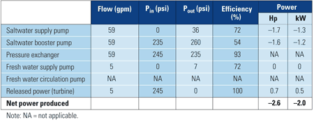

Initial system performance data are presented in Tables 1 and 2. In both tests, the system generated hydraulic power, but at a net loss after accounting for the pumps" energy consumption.
Table 2. System performance data from Test 5. Source: Energy Recovery Inc.

This demonstration of osmotic power production successfully exploited the osmotic pressure between saltwater and fresh water to produce a pressurized stream of diluted saltwater that could be used to drive a turbine. However, the tests consumed more power than they created, indicating losses or inefficiencies in the process. Specifically, three types of losses are evident:
  • The difference between the initial pressure and the osmotic pressure of the saltwater.
  • The pressure drop through the membrane.
  • The decay in operating pressure over time.
When the saltwater was initially exposed to fresh water across the membrane, the saltwater pressure increased as osmotic flow occurred. However, before the saltwater booster pump was started, there was no circulation or agitation of the saltwater, so dilute saltwater near the membrane reduced the osmotic pressure across it. This reduction is seen as the difference between the osmotic pressure of the saltwater (about 415 psi) and the initial static pressure of the saltwater (320 psi in both tests). Once the booster pump was started and the discharge valve was opened, the crossflow of saltwater across the high-pressure side of the membrane elements reduced the accumulation of dilute saltwater in the vicinity of the membrane surface.
The sharp reduction in saltwater pressure after the discharge valve was opened is evidence of frictional losses associated with permeate flow. The difference in permeate rates was insufficient to be detected as differences in frictional losses between the two demonstration tests. Higher permeate frictional losses would be expected at higher flux rates.
