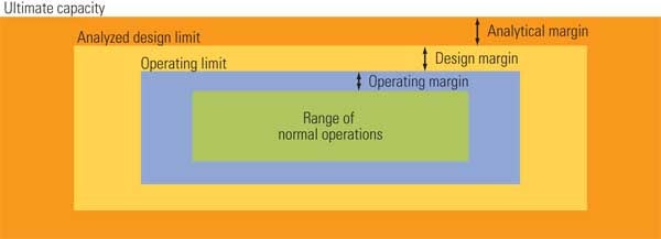

An EPU is a major undertaking for an operating plant that requires the combined expertise of the plant staff, NSSS, turbine contractors, and, in most cases, nuclear EPC contractors. An initial but important step is to establish a margin management program (if the plant does not already have one) to ensure that adequate margins are available in systems, structures, and components (SSCs). Developing or updating the margin management program may be done in parallel with other EPU preparation steps.
Several "margins" are of interest in a margin management program. The Institute of Nuclear Power Operations (INPO) identifies three different ones for nuclear plant design: operating margin, design margin, and analytical margin (Figure 3).
3.    Managing margins. Relative nuclear plant margins as defined by the Institute of Nuclear Power Operations. Source: INPO
Operating margin is the difference between operating limits and the range of normal operation. The operating limit is analogous to design values in engineering terms. It accounts for, and envelops, all the potential operating conditions of the plant. Design codes and licensing criteria all include a certain margin, or safety factor, beyond the design limit, which address uncertainties in design, fabrication durability, reliability, and other issues. The difference between the analyzed design limit and the operating limit is this conservatism, which INPO calls the design margin.
Normal aging and plant operation can eat into each of these margins and requires constant attention by owners. Increased thermal output by an EPU imposes further demands on the operating limit. Even systems or components not directly affected by the power increases may not function as efficiently as intended following an EPU. For all of these reasons the margin management program becomes an important tool in performing an EPU.
