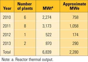

Table 3 lists the number of plants where the owners have already contacted the NRC about an EPU, but the real number of prospective uprates is far larger. At least 60 nuclear units are most likely candidates for an EPU program in the near future, and about 50 of those units are PWRs, which represent 6 to 12 new plant equivalents. The increased interest by PWR owners has been prompted, in part, by advances in technology and, perhaps more importantly, improvements in available fuels. Fuels with slightly higher enrichments, improved cladding, low noncondensable gas releases, and improvements to burnable poisons and better structural stiffness that make the fuel less vulnerable to vibration and fretting have become available over the past couple of decades.
Table 3.    Expected applications for extended power uprates. Source: NRC
