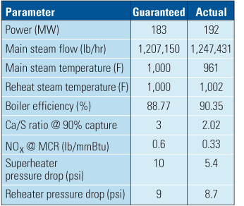

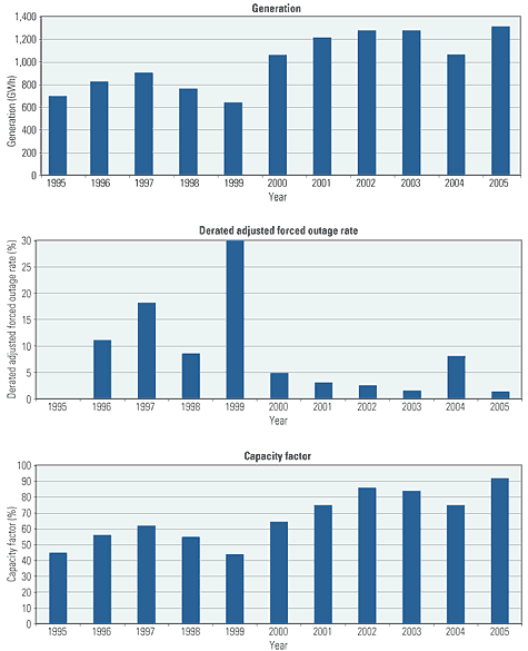

The first full year that Point Aconi operated with all modifications was 2005. That year, the unit's DAFOR was 1.28%—a huge improvement over the 30% of 1999. Capacity factor likewise improved to a very admirable 92%, from 50% in the mid-1990s and 75% in 2001. Total generation increased from 700 GWh in 1995 to 1,365 GWh 10 years later. The unit's rated capacity was increased to 192 MW (gross) and has been maintained while firing 80% pet coke. Hot loop ash surging has been eliminated.
Results of the Point Aconi revitalization program. Source: Nova Scotia Power
Even more significantly, there were no boiler tube failures in 2005; in the worst year, 1996, there were 18 such incidents (Figure 8). The table and the three bar charts of Figure 9 detail the most significant improvements in performance achieved since 2001, when the revitalization program began.

9. Steady improvements. Historical trends of Point Aconi's generation, derated adjusted forced outage rate, and capacity factor. Source: Nova Scotia Power
