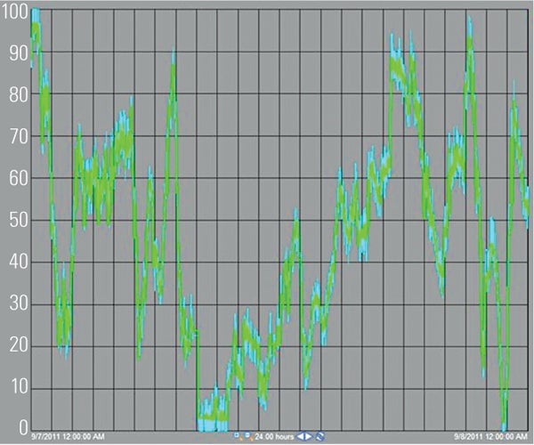

5. Follow the leader. This figure shows the automatic generation control (AGC) signal requested from NorthWestern Energy’s System Operations Control Center (pale blue line) and the output from Dave Gates Generating Station following that signal (green line) over a typical 24-hour weekday. Engines are started and stopped as required to follow the AGC signal. The vertical scale is 100 MW, maximum. Wind power capacity of 150 MW is connected to this system. Courtesy: NorthWestern Energy
As of September 30, 2011, the six engines at the DGGS have operated 16,488 hours, producing approximately 251,000 MWh net. Two-unit availability has been 99.38%, which provides sufficient regulation capacity except in extreme temperature conditions when three units are needed. An impressive 5,465 engine starts have occurred since commercial operation. The plant has served as a reliable replacement for third-party contracts for regulation service by consistently meeting a monthly control performance standard (CPS2) greater than 90%, the required reliability standard (Figure 5, p. 60).
