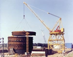

Module lifting. What is the lifting capacity at the site? Large, heavy modules that are constructed in a shop or on a nearby construction pad must be lifted into place. Ideally, if a construction pad is used, it is best to have a crane that can access both the construction pad and the area where the finished containment vessel will be placed on-site. As each piece of the vessel is assembled, the crane lifts it into place. If modules are shipped via truck, rail, or barge, appropriate lifting capacity must be available to lift the pieces into place (Figure 3).
3.    Stacking rings. A modularized ring of a containment vessel is set on the nuclear island containment vessel. Courtesy: CB&I
