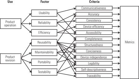

Measure to manage. You can’t manage what you don’t measure. Some in the software business talk of software quality assurance (QA). The diagram provides a high-level overview of the metrics being contemplated for QA evaluations of software.
Inspect, don’t expect. Software quality assurance evaluations often include these metrics. You can’t control what you don’t measure. Source: www.dcs.qmw.ac.uk/~norman/papers /qa_metrics_article/section_3_metrics.html
