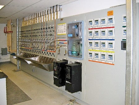

Operators, because they are the primary users of the plant's sample panel (Figure 3), are best qualified to determine if it needs maintenance. Taking the following steps ensures that on-line analyzers read reliably and are repaired when they don't.
3. Water works. A typical sample panel with separate dry and wet sections. Courtesy: Nalco

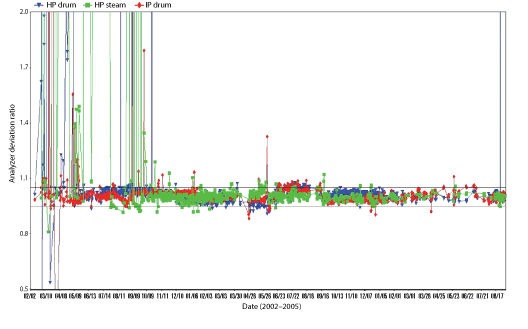

At most plants, shifting primary responsibility for sample panel maintenance to the operator decreases overall maintenance costs. Under such a regime, analyzers are calibrated on an as-needed basis rather than every week, typically saving about four I&C man-hours per week. The frequency with which pH and ORP (oxidation-reduction potential) probes are replaced decreases from about once every six months to about once a year. Another benefit of this approach is that conductivity probes no longer need to be replaced as a step in the preventive maintenance program. Replacing the probes only if they fail will generate net savings averaging about $18,000 per year per site. Sites that do not maintain their sample panel will obviously see their overall maintenance costs rise after implementing this philosophy. But usually the increase is more than offset by the higher unit availability made possible by a reliable and accurate steam sample panel.
4. Settle down. On-line analyzer deviations before and after a change in sample panel maintenance strategy. Source: Nalco
Figure 4 confirms the tangible positive effects of changing a sample panel maintenance strategy. The graph shows how one plant's average analyzer deviation ratio, discussed earlier, fell precipitously with a shift in maintenance philosophy. The correlation between wet test results and sample panel readings was extremely low before the change but much higher after it. The improvement in the accuracy and reliability of on-line analyzers allowed operators to decrease their wet testing frequency to once per day. Figure 5 shows typical, much lower analyzer deviations several weeks after the change.
5. Great expectations.
Typical analyzer performance after the maintenance strategy change shows only minor deviations in readings. Source: Nalco
