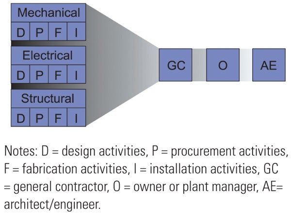

The program is focused on improvement through a holistic perspective of cash conversion processes across company boundaries by combining the firm and the project elements. Lean thinking is applied to eliminate waste and improve operational consistency from project to project in many areas of the blue-shaded zone in Figure 5. Project managers for the contractor make decisions that result in improved overall performance for the business and related projects.

Lean thinking should be applied within an owner’s construction pro¬gram and should cross organizational boundar¬ies through all design and build phases. The goal of lean thinking is to eliminate waste and improve operational consistency from project to project, as shown in the blue-shaded zone. Source: FMI Corp.
