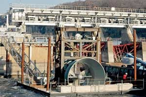

1. Go with the flow. The Hastings hydrokinetic turbine is located behind the turbine of the existing conventional hydropower plant and uses a one-to-one turbine ratio to generate additional power from the energy remaining in the water current exiting the dam and flowing downstream. Also seen is a support barge used during installation. Courtesy: Hydro Green Energy

The rotational speed of the company’s turbine is 21 rpm — the lowest in the hydrokinetic industry (Figure 2). The turbine blades can be stopped from spinning in approximately 8 seconds. In addition, the turbine can be pulled out of the water and placed in the service mode in under 2 minutes, leaving very little infrastructure below the waterline.
2. Hard-working water. After the second turbine is installed this summer, the Hastings hydrokinetic power station is projected to produce a maximum of 1,454 MWh of electricity annually. Courtesy: Hydro Green Energy
