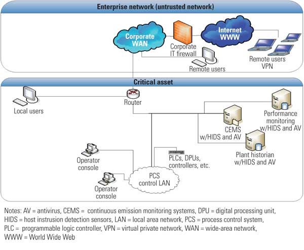

The CIP-007-4 standard requires protection of critical cyber assets, including certain other cyber assets within the ESP (Figure 1).
1.    Lacking cyber safeguards. This diagram shows a critical asset’s control system interconnected with an outside LAN/WAN environmental prior to implementation of the NERC CIP cyber security standards requirements. Courtesy: Industrial Defender
