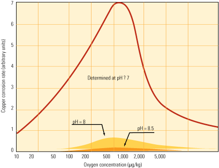

Low-O2, higher pH option. Increasing the pH of the stator water to 8–9 significantly reduces the corrosive response during oxygen transitions (Figure 2). The most direct method for increasing pH is to add controlled amounts of sodium hydroxide to the water. Initially, the sodium will be exchanged with hydrogen on the cation resin of the mixed bed polisher, neutralizing the caustic. If caustic continues to be added, eventually, sodium leakage from the resins will allow the water to maintain an alkaline pH.
2. Oxygen therapy. The effect of pH on copper corrosion rates is significant as oxygen levels increase. Source: Journal of Power Plant Chemistry
Another treatment method is to add a sodium exchange polisher on a side stream and control the amount of water that passes through the sodium exchanger to achieve the desired pH. Some plants have even replaced the mixed bed polisher with all strong base anion resins. However, this polisher will no longer remove soluble copper. Raising the pH also makes it easier to measure the pH of water in the system.
