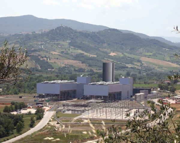

The first application of Low Load Operation Concept (LLOC) technology was at Abruzzoenergia SpA’s 800-MW Gissi combined-cycle plant located in the Abruzzo region of central Italy. Alstom was contracted to design, supply, install, and commission the entire power plant. The fast-track project was given the green light in January 2006 and the plant entered commercial service in early 2008 (Figure 7).
7. Italian plant design. The first commercial application of Alstom’s Low Load Operation Capability (LLOC) was with the two KA26-1 units installed at Abruzzoenergia’s Gissi plant. “KA26-1” designates a single-shaft driveline combined-cycle plant based on Alstom’s GT26 combustion turbine. Each unit is rated at a nominal 400 MW. The LLOC design feature allows Abruzzoenergia to “park” the plant during low power demand periods at about 20% (~80 MW) combined-cycle load. CO and NOx emissions are kept below baseload permit limits while the plant is parked. Courtesy: Alstom
The Gissi plant consists of two GT26 sequential combustion turbines installed in a 2 x 410-MW single-shaft combined-cycle arrangement. Each power train comprises one GT26 gas turbine, a triple-pressure reheat, horizontal heat-recovery steam generator, an STF15C steam turbine using 565C/140 bar high-pressure steam, and a shared hydrogen-cooled TOGAS turbogenerator, all manufactured by Alstom.
