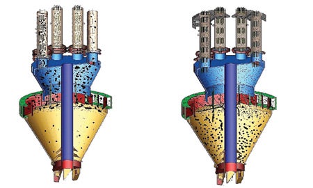

Classifier changes must be made to optimize both fuel fineness and fuel distribution. That is, classifiers can create good fuel balance provided the fuel lines are flow-balanced on clean air (Figure 6).
6. Balancing burners. Balancing burners begins with the classifier on pressurized pulverizers. The classifier has two purposes: to return course particles for regrinding and to balance fuel streams to each burner line. Poor coal fineness often yields poor distribution, because large coal particles and air mix to form a two-phase mixture that will not homogenize (left). Good fineness creates a homogenous and balanced mixture that behaves more like a gas than a two-phase mixture of air and fuel (right). Source: Storm Technologies Inc.

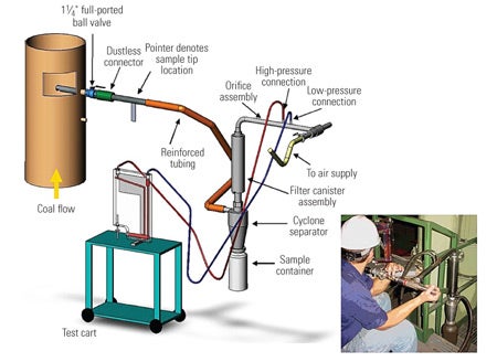

8. Sampling coal fineness. A typical sampling methodology uses an isokinetic coal sampler to determine if the coal pipes are properly balanced and if the coal is ground to adequate fineness. Source: Storm Technologies Inc.
