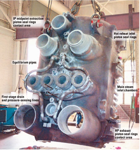

1. In the spotlight. A typical Westinghouse 500-MW BB44 HP-IP steam turbine. Courtesy: Southern Company Generation

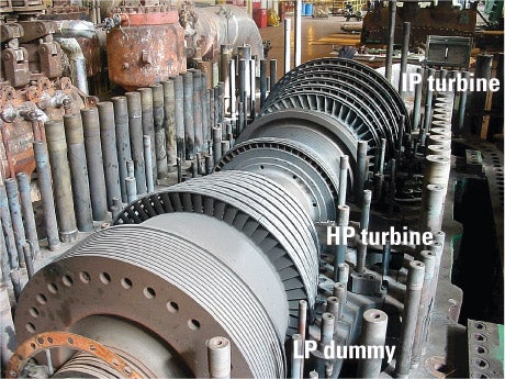

For later (BB44) Westinghouse turbines, the sources of design leakage (Figure 2) include:
  • Main steam inlet bell seals (the leakage bypasses the HP-IP turbine; more recent units indicate zero leakage on the design heat balance).

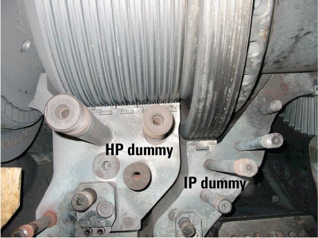

  • HP-IP-LP dummy balance seals (Figure 3).
  • HP exhaust piston seal rings.
  • IP inlet (hot reheat) piston seal rings.
2. Go to the source. Design and nondesign leakage areas on the lower inner shell of a Westinghouse BB44. Courtesy: Southern Company Generation
3. To be smart, test these. The HP, IP, and LP dummy seals of a typical Westinghouse BB44. Courtesy: Southern Company Generation
Depending on the unit design, HP dummy seal leakage can affect HP turbine efficiency as it flows through the equilibrium pipes to the HP exhaust. If the IP dummy ring is severely distorted, it is possible for the IP dummy leakage to be a mix of HP dummy leakage and HP exhaust steam flowing in the reverse direction through the equilibrium pipes.
Among the sources of nondesign leakage are:
  • The HP inner shell horizontal joint (distorted shell or loose bolting).
  • Broken internal equilibrium balancing pipes.
  • A broken first-stage drain or pressure-sensing line between the inner and outer shell.
  • Piston seal rings on the IP turbine mid-point extraction pipe.
  • A missing mid-span balancing port plug in the inner shell.
  • Cracks in the main steam inlet pipes at the trepan radius.
