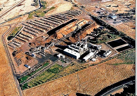

4. Wood-fired CFB. Colmac Energy's 49-MW Mecca Power Plant, located southeast of Palm Springs, Calif. The plant's two circulating fluidized-bed boilers drive a single ABB turbine-generator. The boilers are fueled largely by urban wood waste collected from various sites across southern California's Inland Empire. Some agricultural waste is used as well. The plant entered commercial service in February 1992. Courtesy: Colmac Energy Inc.
