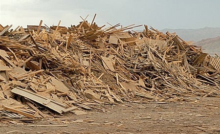

2. Waste? Not. Using urban wood waste as power plant fuel decreases the amount of waste that must be landfilled. Should developers be given economic credit for processing these waste streams? Courtesy: Colmac Energy Inc.

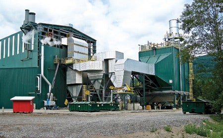

3. Grating wood. The boiler at Hampton Affiliates' 7-MW biomass plant in Darrington, Wash., is equipped with a Wellons stoker-fired rotating grate system and produces 140,000 lb/hr of steam. The plant entered operation in 2006. Courtesy: Wellons Inc.
