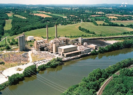

Extending the economic operating life of aging steam plants remains a priority at many utilities, given the challenge of obtaining permits for new generation and the lower cost of life-extension projects. More than half of U.S. coal-fired plants are over 30 years of age, and 10% are more than 50 years old. These veterans still have a lot of fight left in them, given an overhaul or two. But such work can uncover unexpected ailments, as operators at the aging Cromby Generating Station (Figure 1) learned.
1.	Fifty years and counting. Exelon’s Cromby Station has been in commercial service for more than 50 years. Upgrades to Unit 2’s steam turbine should extend the plant’s life for a couple more decades, at least. Courtesy: Exelon Corp.
Exelon’s Cromby Generating Station, located in Phoenixville, Penn., consists of two units: Unit 1 is a coal-fired 144-MW plant; Unit 2 is a 202-MW unit that burns gas or No. 6 fuel oil, depending on market conditions. Unit 1 has accumulated more than 330,000 fired hours since it began commercial service in 1954. Unit 2, commissioned in 1955, remains a favorite dispatch unit in the Exelon fleet and dispels the myth that “it’s the miles and not the age” that determine when a unit should be retired.

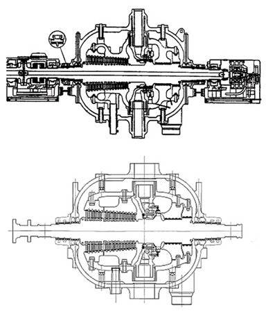

Figure 2 also illustrates the unit’s rotor bearing arrangement. In this configuration, bearing No. 4, between the IP-SFLP and the DFLP (bearing No. 5), is shared by the two cylinders. Figure 3 compares cross sections of the old and replacement HP steam turbines.
3.	Fits like a glove. Mitsubishi Power Systems engineered a new direct replacement HP steam turbine to fit inside the casing of the old steam turbine. Shown are cross sectional drawings of the original (top) and new (bottom) HP steam turbines. Source: MPS
The retrofit project replaced the HP rotor and diaphragms but reused the existing outer casing. The original Curtis control stages were replaced with a single, higher-efficiency Rateau stage, and the reaction blades were redesigned with the latest 3-D design tools. The HP turbine’s inner casing, blade, and dummy rings were replaced; the HP rotor bearings were rebabbitted; and thermocouples for bearing metal temperature were installed. Farther down the driveline, one row of LP L-0 blades and three rows of LP L-1 blades were replaced. The addition of orthogonal vibration measurement instrumentation completed the scope of work. Plant engineers showed excellent foresight in adding this new vibration instrumentation—as you’ll appreciate in a moment.
