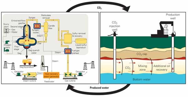

Increasing public resistance to the withdrawal or consumption of freshwater for industrial purposes suggests that the use of nontraditional water sources in power plants may alleviate the expected increase in water demand. Power plant usage of water produced by CO2 -EOR may be an environmentally sustainable alternative for "closing the CO2 -water loop," as illustrated in Figure 4.
4. Closing the CO2-water loop. CO2 is produced in the generation of electricity and then it is injected into depleted oil and gas reservoirs to enhance oil recovery. Water produced in the process is treated and returned to the power plant for cooling and other purposes. Source: U.S. Department of Energy’s National Energy Technology Laboratory

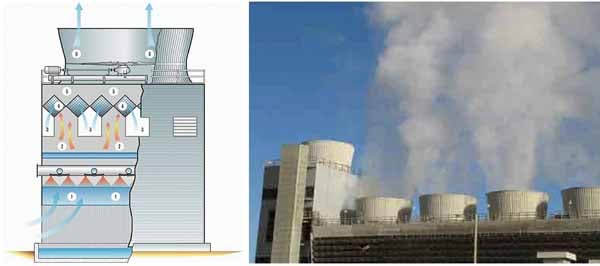

Advanced Cooling Technology. This component of the EPEC program is working to develop advanced wet, dry, and hybrid cooling systems. One of the projects under way in this research area is called "Air2Air Technology to Reduce Freshwater Evaporative Cooling Loss." For this project, SPX Cooling Technologies is investigating the use of an air-to-air heat exchanger above a wet cooling tower, as shown in Figure 5. It takes warm, humid air from the cooling tower and contacts it with cooler, dry air from outside to condense and recover a portion of the water that just evaporated from the cooling tower.
5. Air2Air cooling technology. The tower on the far left of the photo includes Air2Air technology. Note that the steam plume coming from the other towers is effectively eliminated in the Air2Air tower. Source: U.S. Department of Energy’s National Energy Technology Laboratory
This system has the potential to condense as much as 20% of the cooling water that would have been lost to evaporation. If this technology were applied to all wet recirculating cooling towers in the U.S., the water savings could reach 1.56 bgd. In addition, these units are very effective at steam plume abatement. Initial tests of the technology produced positive results, and now follow-up work is focused on analysis of improved geometries of airflow through the units as well as improved seals to enhance liquid capture.
