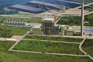

American Electric Power (AEP), one of the largest electric utility power producers and distributors in the U.S., recognizes the need to continue to develop new coal-fired generation to meet projected load growth in its service territories, including west Arkansas and east Texas. To that end, construction on the John W. Turk, Jr. Power Plant (TPP), a 600-MW net coal-fired project that will introduce USC technology into the U.S., began in November 2008 (Figure 1). Integrated gasification combined-cycle (IGCC) was also explored as an alternative, although the supplier guarantees were stronger from the vendor supplying the USC plant. Table 1 illustrates the slight difference in CO 2 emissions from IGCC, subcritical, and USC plant designs considered by AEP.
1.    One of a kind. AEP’s John W. Turk, Jr. Power Plant will be the only ultrasupercritical power plant in the U.S. when the $1.5 billion project enters commercial service in 2012. Shown is an artist’s concept of the project at completion. Courtesy: AEP
