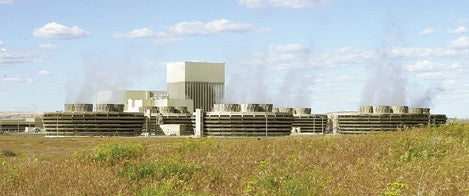

The old digital electro-hydraulic (DEH) turbine control system at Columbia Generating Station (Figure 1), a 1,250-MW boiling water reactor (BWR), was obsolete and not single-failure-tolerant. Component and subsystem failures had resulted in unit trips, power reductions, load swings, and operation in manual control for extended periods of time.
1. Death of DEH. Engineers at Energy Northwest’s Columbia Generating Station replaced the plant’s digital electro-hydraulic control system with a new, fully digital one that is single-fault-tolerant. Courtesy: Energy Northwest
To resolve these problems, Energy Northwest replaced the old DEH control system with a new, state-of-the-art system that is single-fault-tolerant and can be repaired on-line. The new system employs redundant input signal devices, redundant digital signal processors, and redundant output devices. It also features improved control algorithms and start-up and shutdown control procedures, and provides additional information on turbine-generator performance to operators and engineers.
