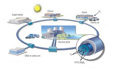

In a certain sense, hydrogen and electricity can be considered "mutually fungible." In a number of instances, each can replace or be transformed into the other—hydrogen as potential energy, and electricity as kinetic energy. However, it will be most realistic to provide both and let the end user decide which to use. Figure 1 depicts just such a scenario on an urban scale. The electric portion of the grid would use high-current DC superconducting cables for power transmission, with liquid hydrogen as the core coolant. The electric power and hydrogen would come from nuclear and other power plants spaced along the grid. Electricity would exit the system at various taps, connecting into the existing AC power grid. The hydrogen would also exit the grid, providing a readily available alternative fuel, perhaps for the next generation of fuel cell–powered automobiles.
1. The grid of the future? In this conceptual drawing, an urban community's entire electricity supply comes from a nuclear plant and rooftop photovoltaic panels. The nuclear plant also generates hydrogen, which is distributed along with the electricity by a SuperCable ring bus. Source: Dr. Paul Grant
