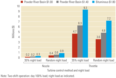

Even assuming a nightly load reduction to 35% to 80% every night over an entire 20-year evaluation period, the present value of the difference in operating costs is calculated to be only $0.5 million for PRB coal firing and less than $1 million for high-sulfur bituminous coal firing of a modern 650-MW unit with nozzle control. As Figure 8 makes clear, the present value of 20 years of operating cost savings is not nearly enough to justify the additional $6 million to $7 million capital investment required for the sliding-pressure steam generator. Meanwhile, the sliding-pressure turbine cost savings are reportedly estimated to be on the order of $0.5 million and would be partly offset by any additional feedwater heater and steam generator costs to handle sliding pressure and any associated load and pressure cycling.
Source: Riley Power Inc.
8. Investment payback. The chart shows simple 20-year present value of operating cost savings with sliding pressure on a 650-MW unit. Additional cost for a sliding-pressure steam generator is estimated as $6 million to $7 million.
