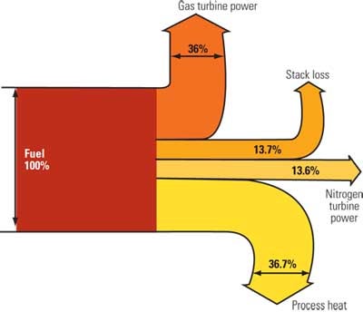

For the independently fired closed Brayton cycle (Figure 5) the only major heat loss is the flue gas — about 14% of the energy input (Figure 7). The marginal energy to be provided by combustion over that required for simple re-evaporation is calculated, as before, as 1,075 – 843 = 232/0.85 = 273 kJ. At a methane evaporation rate of 1,000 tonnes per hour, 273,000 MJ/h of fuel would be required to give a net power output of 54 MW, equivalent to a heat rate of 5.06 kJ per kWh (4,793 Btu per kWh). This corresponds to a fuel cost of 2.4 cents per kWh. The value of power over 7,500 annual hours of operation is $20.25 million against a fuel cost of $9.72 million.
7.    Point the way. This Sankey diagram for a dual Brayton cycle regasifier plant shows how the fuel is consumed. The output and efficiency of the dual Brayton turbine system are comparable to those of a conventional gas/steam combined cycle, with no requirement for water or cooling system other than that provided by the methane re-evaporation process. Source: Battelle

Using these same assumptions, a modern combustion turbine exhausts about 44.6% of its fuel input as waste heat, compared with 36.7% used for the revaporization process using a closed Brayton cycle (Figure 7). For an evaporation rate of 1,000 tonnes per hour at 843 kJ/kg, the energy converted to electric power would be 44.6/36.7 x 843 = 1,024,000 MJ per hour, which is equivalent to 284 MW. The additional hourly fuel cost is $6,186, and the value of the power produced is $14,200. At a cost of $1,000 per kW for the turbo-generator and 7,500 hours of operation per year, the payback period for the Brayton cycle option is also under five years, yet this option uses more than three times the amount of revaporized LNG to run the process.
