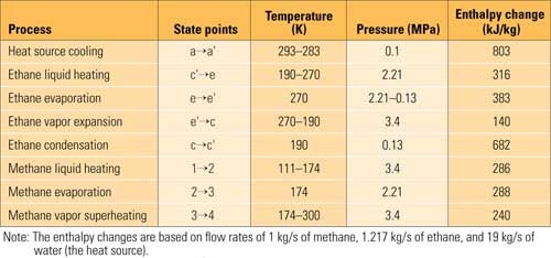

Figure 2 shows a Rankine cycle (in red) superimposed on representations of the temperature and enthalpy changes of a seawater heat source (a→a’) and a heat sink consisting of a subcritical pressure liquid methane revaporization system (in blue). The physical processes for the subcritical case represented in Figure 2 are detailed in Table 1. Note that 81% of the heat input is conveyed to the methane via the exhaust stream.
2.    Puzzle parts. Temperature-enthalpy plots for an ocean heat source, Rankine power cycle (shown in red) and liquid methane regasification process (shown in green). The working fluid in the Rankine cycle is assumed to be ethane. See Table 1 for data details. Source: Battelle
Table 1.    Thermodynamic properties for state points shown in Figure 2. Source: Battelle

You may recall from basic thermodynamics class that the classic heat engine requires a heat source and a heat sink at different temperatures in order to produce work. The key to understanding the proposed LNG revaporization processes that follow is that the temperature difference between the heat source (a→a’) and the heat sink supplied by the liquid methane (1→4) is sufficient to operate either a Rankine or a Brayton cycle heat engine. The similarity between the temperature-enthalpy profiles of the Rankine cycle and the methane evaporation process allows the cycle designer to marry those two processes. With the proper choice of the Rankine cycle working fluid, cycle parameters, including the relative mass flow rates of the different working fluids and power production, can be calculated.
