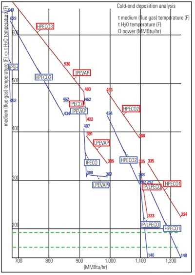

Figure 3 shows the cold-end portion of the heat-energy-temperature (QT) diagram from the simulation run with the GT outlet (HRSG inlet) conditions corresponding to the OEM full-load base design case. The green dotted lines show the probable range (160F to 190F) for the sulphuric acid dew point, which is calculated using typical values for fuel gas sulfur and exhaust moisture content.
3. Chilly forecast. The boiler simulation run predicts the cold-end temperature profile. The calculated most-probable range of acid dew point is shown by the green dotted lines. Courtesy: Tetra Engineering Europe
Clearly, the last sections of the high-pressure economizer 1 (HPECO1) and the split intermediate-pressure/low-pressure (IP/LP) economizers are below the temperatures where acid may potentially condense on the tubes. These modules, each comprising seven rows, are located in parallel in the gas path and therefore have the same temperature profiles.

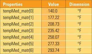

The fluid temperature predicted by the model at the entrance to each row of IP/LP economizer tubes is shown in Table 1. From this data it appears that only row 1 and possibly part of row 2 are at risk for deposition.
Table 1. The acid test. Simulations are performed to determine if the fluid temperatures are such are that acid may potentially condense on the tubes. Inlet water temperatures to rows 1 through 7 of IP/LP economizer are shown. The first value is for row 1 nearest the HRSG exhaust stack. Courtesy: Tetra Engineering
Europe
The temperature profile in a tube row can be obtained from the boiler simulation. It shows that only the lower half of the tube is susceptible to cold-end deposition.

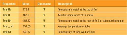

As mentioned above, the metal temperatures in the tube are assumed to be identical to fluid temperatures. This can be verified and the zones that are at risk for deposition further refined. Table 2 shows the tube average temperature profile from the inside wall (which is essentially at the fluid temperature) to the fin tip. The temperature difference is just under 25F. A similar difference is found in the other tube rows. It has been shown that acid condensation in environments with few particulates (such as in HRSGs fired with natural gas) will be small at temperatures that are just within a few degrees of the dew point. This observation would imply that much of the surface area of row 2 would not be at risk of deposition.
Table 2. Looking for trouble. This is the averaged tube temperature profile for row 1 of the IP/LP economizer. Comparing the metal temperatures with the fluid temperatures can reveal potential risk for deposition. Courtesy: Tetra Engineering Europe
