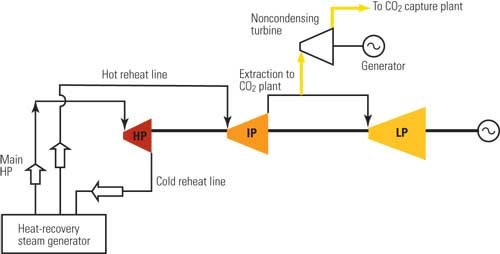

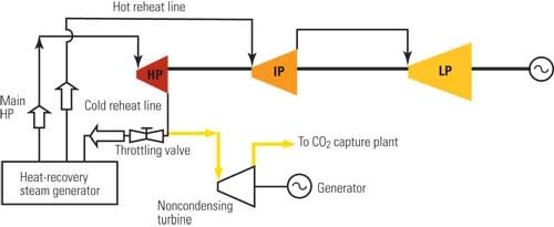

  • Throttle cold reheat IP. This approach uses IP steam but with the addition of a throttle valve designed to keep the IP pressure constant even when large quantities of steam are extracted. This approach would be selected when the IP and LP turbines are located in the same casing and no IP-LP crossover or LP extraction is possible. Although significant throttling losses occur, this setup offers flexibility to extract any amount of steam needed (that is, for less than 90% CO2 capture scenarios) and the capability to restore full power generation rapidly when the CO2 capture system is not in operation (Figure 3).
    3. Steam extraction from IP/LP turbines.
    Source: Bechtel
  • Backpressure turbine. If the steam extraction for the postcombustion capture plant is taken from an IP/LP crossover pipe, the pressure and temperature are too high for direct use in the sorbent regeneration process. The best solution is to recover much of the available energy to generate additional power through a noncondensing turbine to supply the required steam pressure and temperature to the carbon capture process while reducing the additional auxiliary load (Figure 4). The less-desirable alternative is to spray water in an oversize attemperator.
    4. Steam extraction from HP cold reheat steam line. Source: Bechtel
