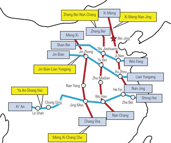

A strong and smart grid requires an information and communication platform with the means of intelligent control. Incorporating generation, transmission, substations, and power distribution, a smart grid can allocate AC and DC rationally and cover all voltage levels to adapt to the development of inter-provincial transmission. Above all, smart grid is a modern grid that is strong and reliable, economically effective, and environmentally friendly. The UHV power grid plan by 2015 for China is shown in Figure 8. In contrast with smart grid developments abroad that stress demand side management, power transmission is also important for China.
8. UHV power grid plan by 2015. Source: State Council, The 12th Five-Year Plan for National Economic and Social Development

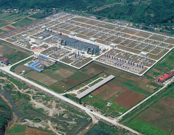

In addition, it is needed to strengthen the distribution network construction to improve power supply reliability and meet the needs of distributed energy development. It is estimated that a strong and smart grid, which is centered on an UHV synchronous network and with the characteristic of high security and reliability, will be built by 2020. It can also achieve large-scale energy resource allocation optimization with high efficiency (Figure 9).
9. Modern transmission projects. China, which in 2008 had already completed one 1,000-kV UHV AC circuit, in July put into operation the 2,000-kilometer, 800-kV Xiangjiaba-Shanghai link. Two other 800-kV DC circuits recently completed construction. The Longquan high-voltage DC converter station shown here is similar to those used at China’s massive hydropower transmission projects. Courtesy: ABB
