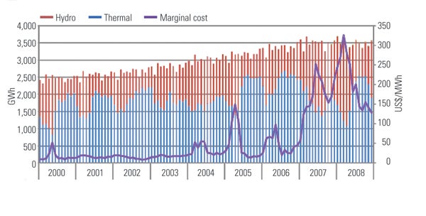

As Figure 1 shows, the price of power increased about tenfold in Chile over the past three years, resulting in decreased industry competitiveness. For example, Claudio Ramirez of EDYCE, a large-scale steel producer, explained that the high cost of energy in 2008 forced his company to temporarily cancel its night shift. However, high marginal prices, together with low barriers to entry, made energy projects more attractive and helped to encourage a rush of investment into the energy sector.
1.     Price spike. The cost of power in Chile increased roughly tenfold between mid-2006 and early 2008 due to the combination of droughts, gas reductions, and high oil prices. Source: CNE

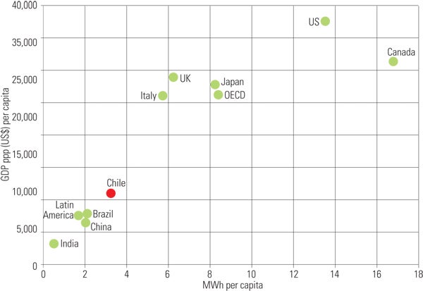

As Figure 2 shows, Chile is still at an emergent stage in terms of energy consumption. The country currently has 12,000 MW of capacity and intends to reach 25,000 MW by 2020.
2.    GDP per capita vs energy consumption. As Chile’s economy grows, so will its energy consumption. Source: International Energy Agency, 2006
