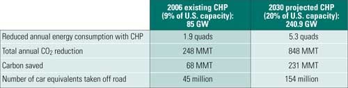

Significant energy and carbon savings today, but more tomorrow. This estimate of the potential for CHP used 2006 data (first data column) to compute the annual fuel use and CO2 emissions of existing CHP facilities. Savings are based on comparison with facilities using separate heat and power consisting of on-site thermal energy supplied by the same fuel type and average fossil-based electricity generation with 7% transmission and distribution losses. The second column of data extrapolates existing CHP performance to proposed 2030 capacity, using the same assumptions as for the 2006 base case. Source: U.S.EIA Annual Energy Outlook 2008 and eGRID, EPA
