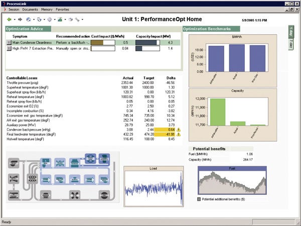

As part of the first stage of the project, Units 1 and 2 also were retrofitted with NeuCo's PerformanceOpt system. Because it embeds a first-principles–based integrated boiler and steam cycle model within an optimization software framework, PerformanceOpt can monitor unit operations in real time.
Displaying its results on customized screens, the system provides real-time detection of fine-grained efficiency and capacity losses based on model-predicted achievable values under current plant conditions. PerformanceOpt's home screen (Figure 5) provides current and historical overviews of performance, identifies operational problems, and quantifies their impact on unit capacity and efficiency. The software is smart enough to know whether to take action to fix a problem or recommend having operators investigate it further.
5. Bird's-eye view. PerformanceOpt's home screen delivers tailored efficiency and capacity knowledge to Baldwin's unit operators. Courtesy: NeuCo
