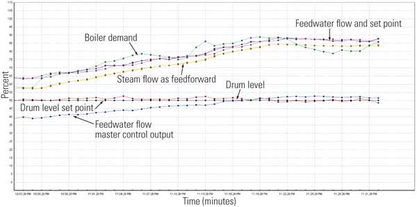

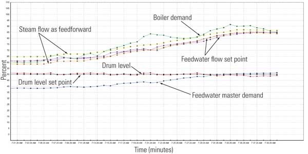

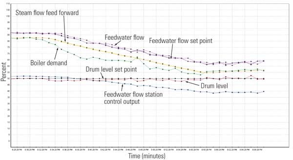

Normally, tuning for the single-element controller consists of big proportional and very small integral gain settings. Tuning for the three-element controller has some additional requirements. As in any cascaded loop, it is absolutely crucial that the inner controller be tuned as tightly as time will allow. The inner controller, the feedwater controller in this case, must have an integral action that is faster than that of the outer, or drum level, controller (Figure 4). This is true for all cascade loops.
4.    Rapid responder. A typical coal-fire boiler with a properly tuned drum level control will respond very quickly to a substantial load increase (top) or load decrease (bottom). The dynamic response of other key variables in boiler drum level control system is also illustrated. Source: Tim Leopold
You may notice that as the load decreases, the drum level sags downward, and as the load increases, the drum level is slightly elevated. This means that the steam flow feedforward is just a tad too strong. A minute adjustment to the feedforward signal can add stability to the control loop (Figure 5).
5.    Small is big. A small increase in the feedforward signal added more stability to the drum level controls. Only very small incremental changes in feedforward should be made when tuning drum level controls. Source: Tim Leopold
