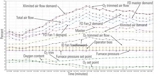

Forced draft fans are typically placed in automatic after the ID fan master is placed in automatic. Usually, the FD fan master is only controlling airflow; however, some boilers are designed with secondary airflow dampers that control the airflow. In this case the FD fan will control the secondary air duct pressure to the dampers (Figure 2).
2.    Favorite trend. I typically monitor airflow, O2 content in the flue gas, and furnace pressure control when I tune airflow. The particular response of those variables was observed after a 20% load increase in coordinated control mode. Source: Tim Leopold
