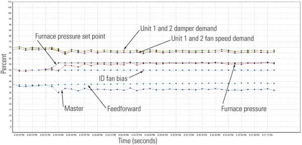

A typical mistake made by boilers tuners is the use of very fast integral action to the furnace pressure controller. Furnace pressure changes quickly, but not instantaneously, so consider the size of your furnace and the amount of duct work between the furnace and the fans as capacitance in the system, because air is compressible. I recommend restraint when tuning furnace pressure when it comes to adding integral gain. Interestingly, the feedforward for almost every boiler is on the order of 0% to 100% in, and 0% to 80% out.
The trends in the following figures show what you should expect to see from your furnace pressure control. The plant from which these data were taken uses both fan inlet damper position and fan speed to control furnace pressure. Figure 1 illustrates an ID fan tuning trend and the reaction of the ID fans and the furnace pressure to a change in set point.
1.    Blowing hot air. Induced draft fans are used to control furnace pressure and primary combustion airflow. In this test, induced draft fan and furnace pressure respond to a step increase in furnace pressure set point. Source: Tim Leopold
