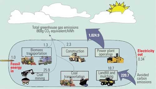

The main reason to use cofiring, of course, is environmental: Sustainably grown biomass is widely recognized as a greenhouse gas – neutral fuel (Figure 2). Although other renewable options, such as wind and solar energy, are "cleaner," in that they do not require burning any fossil fuels, cofiring directly reduces the levels of sulfur oxide, nitrogen oxide, and carbon dioxide from emissions-heavy coal-fired facilities. Accordingly, cofiring should be an increasingly attractive option in today’s regulatory environment.
2.    Carbon neutral or better. The carbon lifecycle and energy balance when cofiring 15% biomass with coal. In this example, carbon emissions are reduced by 18%. Source: National Renewable Energy Laboratory
