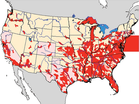

Asiatic clams. Corbicula fluminea have been in the U.S. the longest of the three species. They began arriving on the West Coast from Southeast Asia in the 1920s. By the 1970s, they had become strongly established in the Midwest. By the 1980s, they had reached the East Coast. Figure 8 shows their current distribution.
8. Eighty years of migration. The current distribution of Asiatic clams in the U.S. Courtesy: U.S. Geological Survey

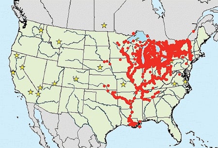

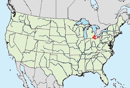

Zebra mussels. Dreissena polymorpha are a newer arrival. They were first found in Lake St. Clair (between Detroit and Windsor, Ontario) in 1988. Figures 9 and 10 show the distributions of zebra mussels in the U.S. in 1988 and 20005, respectively. America's first zebra mussels were international stowaways in the ballast water of cargo ships from the Black Sea. After the ships made their way down the St. Lawrence Seaway, the mussels were discharged along with the ballast water.
9. Then . . . Zebra mussel distribution in the U.S. in 1988. Courtesy: U.S. Geological Survey
10. . . . and now. Zebra mussel distribution in the U.S. in 2005. The stars indicate isolated waterways and cooling systems where mussels have been found recently. Courtesy: U.S. Geological Survey
The maritime shipping industry has tried to prevent zebra mussels from becoming established west of the Continental Divide by stepping up inspections of ships' bottoms, boat cleaning, and other methods. To date, these efforts have been only partially successful. The yellow stars in Figure 10 pinpoint where zebra mussels have recently been found, both east and west of the Mississippi.

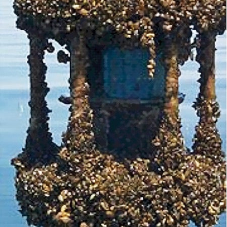

Zebra mussels have a lifespan of two to five years and are slightly larger than Asiatic clams—up to 2 inches across. At that size, they can completely block water intake structures on lakes and rivers. Zebra mussels attach to the structures (and to each other, forming colonies) by means of byssal threads. Colonies have been reported achieving densities of 750,000 to 1,000,000 mussels per square meter. Figure 11 shows a particularly bad infestation.
11. Submarine attack. Zebra mussels blanketing an underwater structure at a power plant. Courtesy: M&M Engineering

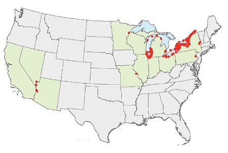

Quagga mussels. Dreissena bugensis, close relatives of the zebra mussels, are the most recent biological macrofoulant arrival. They were first detected in the U.S. in 1989. According to one source, the density of quagga mussels on the bottom of Lake Michigan increased from 899 per square meter in 2000 to 7,790 per square meter in 2005. By January 2007, quagga mussels had been discovered in Lake Mead, Lake Mohave, and Lake Havasu (Figure 12).
12. Go west, young mussel. Quagga mussels' current distribution in the U.S. The red dots indicate recent outbreaks. Courtesy: U.S. Geological Survey
