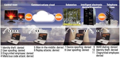

The cyber security recommendations shouldn’t have come as a surprise because the experts on the task force know that it’s not hard for any reasonably accomplished hacker to break into interconnected utility control systems. In North America and the rest of the developed world, such control systems are unprotected by commonly accepted cyber security practices, including logging. As a result, those systems are unable to prevent, detect, or produce audit trails of an intentional or unintentional cyber event. It’s more than a little unnerving to consider how much damage can be done to the power grid by a few keystrokes from ill-intentioned hackers sitting at computers anywhere in the world (see figure).
How to thwart an attack. Attacks on utility SCADA networks can occur at any point in the chain of communications. A virtual “electronic security perimeter” should be used to thwart these attacks, regardless of source or target. The host provides control and monitoring of the data network and data logging. The remote service module (RMS) encrypts and compresses network communications with the central host. The remote modem defender (RMD) is the gateway between the network, maintenance land lines, and control points that use analog dial-up lines. Source: Aegis Technologies Inc.
