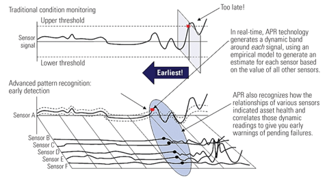

Anomaly detection and alerting via advanced pattern recognition (APR) software using SmartSignal’s EPI*Center, which pulls near-real-time data from the plant PI servers, is installed on 36 units. APR software filters data for subtle changes in parameter values or trends and alerts the PM&DC staff when they occur. The important difference is that these alerts occur much earlier than the plant’s standard supervisory systems alarm setting would, giving operators more time to react when a critical event occurs (Figure 1).
1. Early detection is the key. Early detection of impending equipment failures requires a custom mix of specialized software tools and highly experienced operating and technical specialists. The Entergy PM&DC routinely identifies equipment problems before the plant’s supervisory instrumentation reaches alarm limits. Source: Entergy
