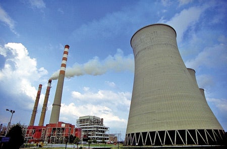

Tennessee Valley Authority’s (TVA’s) Paradise Fossil Plant, located in western Kentucky, consists of three units that began commercial operation between 1963 and 1970 that have a total generating capacity of 2,273 MW (Figure 1). In 2007, there was trouble in Paradise at Unit 3.

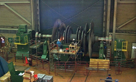

2. Double rotor inspection. The low-pressure turbine is configured with two, double-expansion turbines. This is the Unit 3 LP-B rotor chucked up in a lathe for machining. It weighs 308,275 pounds and is 17 feet from tip to tip of the largest blades. Courtesy: TVA
TVA’s standard steam turbine inspection interval is approximately 10 years. The spring 2007 maintenance outage at Unit 3 included a standard nondestructive examination (NDE) rotor inspection with phased array ultrasonic test (UT) inspections of the L-2 and L-3 blade wheel attachments in the LP turbines. Test results showed multiple indicators of what was believed to be stress corrosion cracking (SCC) on both LP rotors. The indicators were confined to the L-2 and L-3 stages of each LP rotor, although the extent and severity of cracking in the dovetail attachments was different between the stages.

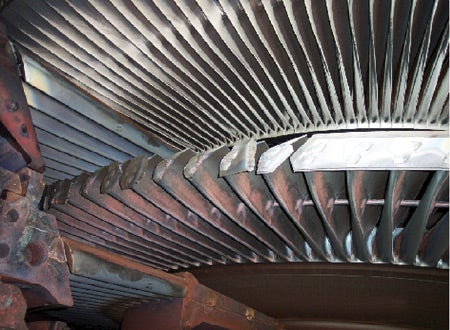

There are 127 blades plus 1 locking (notch) blade in the L-3 row. Also, the L-2 stage on the LP-B rotor shroud covers on a section of the stage appeared to have moved outward and contacted the stationary diaphragm (Figure 3). The shroud failures and disk root indications strongly suggested that an early, extended repair outage was necessary.
3. Shroud of turbine. The inspection also found that the LP-B rotor L-2 stage shrouds had failed. Courtesy: TVA

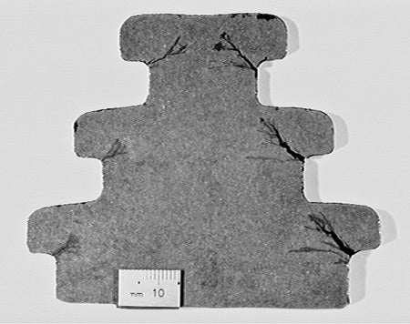

The vulnerability of the L-3 stage dovetails to SCC during normal operation is limited because minimal wetness is present at this location. The steam dry-to-wet phase transition zone in an LP turbine is typically the location of the worst SCC. In the case of Unit 3, SCC was identified in both LP turbine rotors. Severe cracking in the dovetail of a typical fossil LP turbine is illustrated in Figure 4.
4. Imminent failure. A typical low-pressure steam turbine blade dovetail damaged by stress corrosion cracking, which can cause extensive damage if the condition is not quickly corrected. Courtesy: TurboCare Inc.

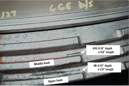

For the LP-B rotor’s L-3 stage, TVA elected to remove the notch blades to confirm the UT inspection results as well as the location and extent of the indications. A magnetic particle test (MT) was used to confirm the indication depth and length. Only two of the eight indications reported by the UT were confirmed with MT, but another five indications were found by MT that had been overlooked by UT.
From a remaining life standpoint, the worst combination of indications were aligned circumferentially at the stage 2T upper and middle hooks near the notch entry after excavation (Figure 5).
5. Many indications found. LP-B rotor critical indications numbers 8 and 10 on the L-3 stage discharge side middle and upper hooks are shown after completing excavation. The indications were caused by stress corrosion cracking. Courtesy: TurboCare Inc.

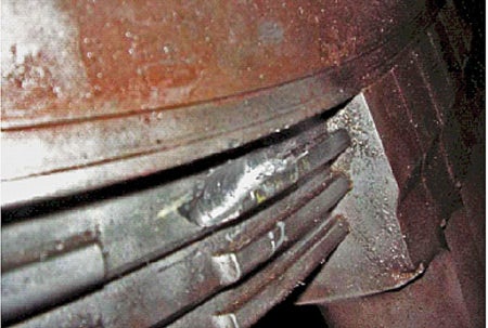

Additional UT tests of the L-3 stage LP-A rotor were performed in April 2007. The most significant indications were reported in lower dovetail hooks of the L-3 stages. The worst indication was measured by MT after excavation as having a maximum depth of 0.56 inch and a length of 2.5 inches (Figure 6).
6. More problem indicators. LP-A rotor critical indication number 8 is illustrated on the L-3 discharge side lower hook. An excavation of 0.5625 inch x 2.5 inch was ground out for the repair. Courtesy: TurboCare Inc.

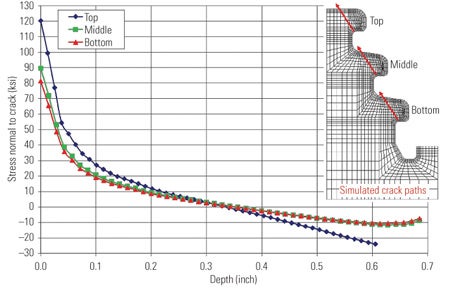

To determine which option to choose, TVA’s detailed analysis began with collecting the dovetail profile dimensional data and constructing a finite element model (FEM) of the L-3 dovetail. A plot of the rotor dovetail region of the FEM is shown in Figure 7, as are the calculated stresses normal to typical dovetail crack trajectories. These stress distributions are normal to the plane of cracking away from the notch entry, at rated speed (1,800 rpm). The blade root (dovetail) FEM section (Figure 7) was also included in the FEM with gap (contact) elements simulating load transfer from the blade to the disk at the top, middle, and bottom loading lands.
7. Stressed blades. A finite element model of the LP-A L-3 dovetail determined the level of stress found normal to the cracks and included load transfer from the blade to the disk on the three lands. Source: TurboCare Inc.
The stresses do not include the load increase at the notch entry. This is accounted for in LPRimLife software using a load scale factor. LPRimLife is a program that evaluates the remaining life of rotors with known or suspected blade-attachment cracking. Its development by Structural Integrity Associates was sponsored by the Electric Power Research Institute.

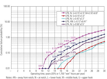

Evaluating simulation results. The probabilistic simulation results from LPRimLife estimated the “cumulative probability of failure” versus operating time in years for each of the three repair options:
  • The “do nothing” option returned very high failure probabilities for the notch after another year of operation.
  • The option of pinning the blade to the wheel as an interim fix significantly reduced the failure probability to below 1% for five more years of operation.
  • The option of replacing the banded group of blades at the entrance notch with titanium blades resulted in a prediction of 10 more years of operation with a failure probability below 0.01%, or 20 more years with a failure probability below 0.65% (Figure 8).
8. Option 3 selected. The choice of repair strategy for LP-A rotor stage L-3 (stage 6) dovetails was determined by a detailed probabilistic analysis by Structured Integrity Associates using the LPRimLife life assessment computer program it developed for EPRI. The analysis results showed that using titanium blades with notch blades pinned to the wheel, with three pins in the axial to the wheel and four cross-pins, was predicted to deliver 10 more years of operation with a failure probability below 0.01%, or 20 more years with a failure probability below 0.65%. Source: TurboCare Inc.
TVA selected the third option as the most effective interim repair for mitigating the risk of dovetail failure at the notch.
