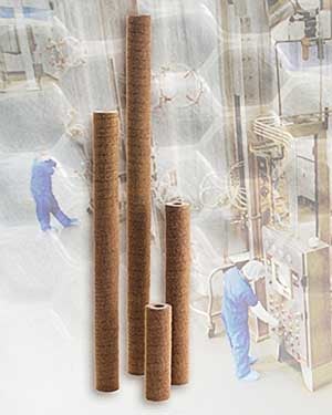

Pentair Industrial has introduced its Resflex Series Resin Bonded Filter Cartridges, with a unique, proprietary two-stage design. The cartridges’ outer spiral wrap efficiently removes large particles and agglomerates. This prefilter wrap provides increased surface area and intensifies cartridge strength, while eliminating residual debris. Resflex’s inner layers provide superior particle removal from 2 to 150 microns. Flow rates are 10 gpm per 10 inches of cartridge length, with cartridges available in sizes up to 40 inches. The patented design maximizes filtration and service life, removing contaminants from viscous fluids at temperatures up to 250F.
Resflex cartridges are impregnated with phenolic resin — making them suitable for use with fluid viscosities up to 15,000 SSU. Unlike "short fiber" cartridges, Resflex contains extra-long acrylic fibers that resist breakage, help prevent migration, and provide additional cartridge strength. (www.pentairindustrial.com)
