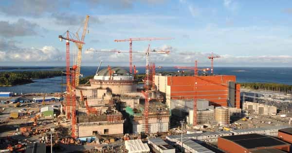

Olkiluoto 3, the world’s first EPR whose construction in Finland has been plagued by major delays, in September reached a significant milestone as its 200 – metric ton, 47-meter-diameter steel dome was hoisted into position 44 meters above the ground (Figure 1). The massive concreting process for the internal structures of the reactor containment have also now been completed, all large components have been installed in the turbine building, installation of piping and electrical equipment is nearing completion, and erection of piping and other installation work will now start on a large scale, Finnish utility Teollisuuden Voima Oyj (TVO) said in October.
1.    Raising the roof. The world’s first EPR, Olkiluoto 3, in September reached a major milestone with installation of the reactor dome. Two cranes hoisted the steel component weighing 200 metric tons and measuring almost 47 meters across and lowered it into place 44 meters above the ground. The inner section of the reactor building is now completely covered, and to seal it, the dome will be welded around its circumference and covered with 7,000 metric tons of concrete. The project, expected to come online in 2012, is three years behind schedule, plagued by planning and material delays. Courtesy: AREVA
