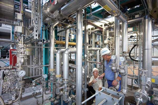

E.ON, Siemens Start Up Carbon Capture Facility at Staudinger. In mid-September, E.ON and Siemens switched on a 1-MW pilot plant that will test postcombustion carbon capture on Unit 5 at E.ON’s hard coal – fired 510-MW Staudinger facility in Grosskrotzenburg near Hanau, Germany (Figure 2). The facility, designed to be retrofitted onto existing plants, will operate until the end of 2010. Findings will serve a large-scale demonstration of the technology, and E.ON expects that an industrial-scale CCS coal-fired plant could come online in 2020.
2.    A postcombustion pilot. German giants E.ON and Siemens in September launched a pilot project to test postcombustion carbon capture on Unit 5 at E.ON’s hard coal–fired 510-MW Staudinger facility in Grosskrotzenburg near Hanau, Germany. Siemens’ process uses a proprietary scrubbing agent to trap 90% of low-temperature carbon dioxide from flue gases in an absorber. Courtesy: E.ON
Siemens developed the postcombustion capture process, which uses a scrubbing agent — a "special cleaning agent" — to trap about 90% of low-temperature CO2 from flue gases in an absorber. The CO2 -laden agent is then fed into a desorber to get rid of the greenhouse gas by raising the temperature, before feeding the regenerated agent back into the absorber.

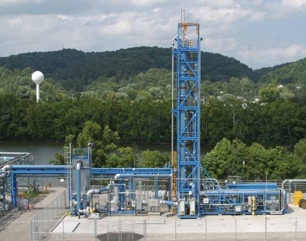

Alstom, Dow Facility to Test CO2 Capture from Flue Gas. Alstom teamed with the Dow Chemical Co. to start up a 2-MW pilot plant that captures CO2 from the flue gas of a coal-fired boiler at the Dow-owned facility in South Charleston, W.Va. The pilot plant uses proprietary advanced-amine technology jointly developed by Alstom and Dow to capture approximately 1,800 metric tons of CO2 per year (Figure 3). It is expected to operate for the next two years. Data from the test will be use to optimize the technology, the companies said.
3.    Amine, Amen. Also this September, Alstom and The Dow Chemical Co. started up a 2-MW pilot plant to capture CO2 from the flue gas of a coal-fired boiler at the Dow-owned facility in South Charleston, W.Va. The process uses the companies’ jointly developed advanced amine technology to capture about 1,800 metric tons of CO2 per year. Courtesy: The Dow Chemical Co.

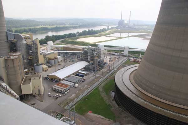

AEP Readies Mountaineer Validation Project for Commissioning. Meanwhile, American Electric Power told POWER in September that it had started its 20-MW carbon capture system to confirm that it was capturing a clean stream of the greenhouse gas for the $76 million validation project at its Mountaineer plant (Figure 4).
4.    The acid test. American Electric Power is preparing to commission a 20-MW carbon capture and sequestration system (shown here between the stack and the cooling tower) that is expected to remove and sequester some 100,000 metric tons of CO2 emissions annually from the flue gas stream of the utility’s 1,300-MW Mountaineer plant in New Haven, W.Va. The system uses Alstom’s chilled ammonia process. Courtesy: AEP
The project will officially be commissioned on Oct. 30. The Mountaineer project will then operate for up to five years and help validate the effectiveness of Alstom’s patented chilled ammonia process for carbon dioxide capture and the viability of storage in the local geology. The project is being watched closely around the world because it will be the first to capture CO2 from a pulverized coal – fired power plant — as well as inject it into a permanent storage site more than 7,800 feet underground. It has also been hailed for its potential to provide the critical information that could scale up capture and storage technologies for new power plants and for the retrofit of existing facilities.
